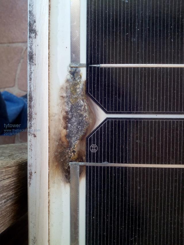

Has anyone got a picture of a burnt panel that was not intentionally lit?
I have one of a pretty badly water/corrosion damaged one and its still up on the roof doing just fine with my switches where they should be just before the inverter.

That doesn't look good.
Wonder if you could do some surgery from the back and epoxy or polyurethane it back up to seal it from the elements? Don't think I'de leave that on the roof myself.
